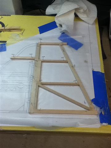

Postby phjoker » Fri Mar 25, 2011 12:14 pm
Well I must have dry fitted the wings like 10 X and I am happy with the way they line up.

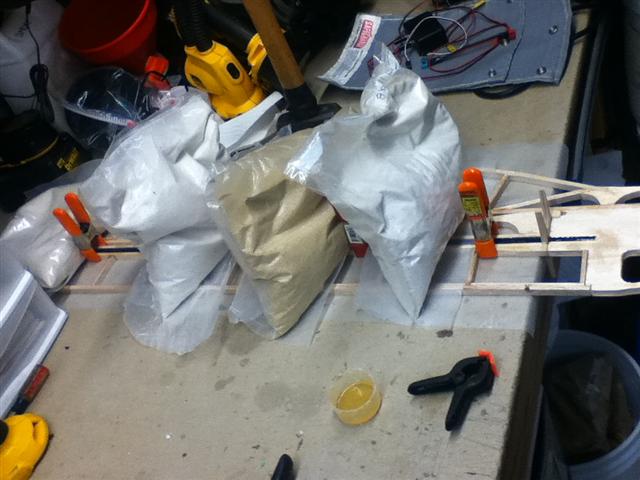

So I layed the fuse on some wax paper and put the fuse tube in. If you look at the front of the fuse you see the wing joiner with the tube running right through it.. I mixed up some 30 min epoxy, and began to drizzle it between the wood and the tube. I then took a heat gun and heated up the epoxy that I just put on so it will run between the tube and wood.
Then I clamped and weighted it down. I will let this sit over night
Now I was short some 1/4 3/8 balsa sticks. It seems the wood list says on thing and the print says another. So Luckily Haggie had a plank of 1/4" balsa wood and cut me what I needed . Now I can start on my Fuse and rudder

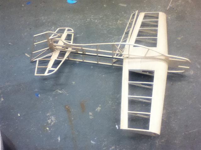

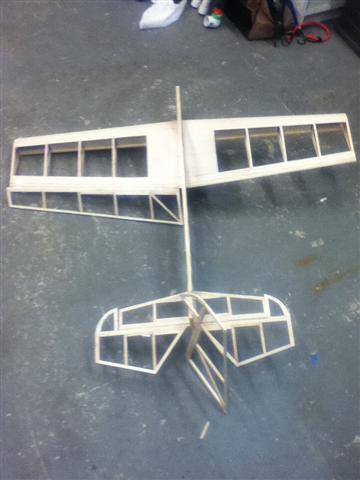

Postby phjoker » Wed Apr 06, 2011 6:40 pm
Well Haggie has his plane. He is almost done covering it already.. Maybe he Will post some pictures when he gets a minute or two. :poking
Mine is almost done being built. I am epoxying the fuse tube in as I type this. Wings are done and finished sanded as well as the rudder,elevator and Ailerons. Mine will be making its way up to Haggie's house shortly for covering.

Postby phjoker » Wed Apr 06, 2011 9:36 pm
Well here are two shots of it in the Bones...... Yea Sorry you only get to see only 1 aileron :dude

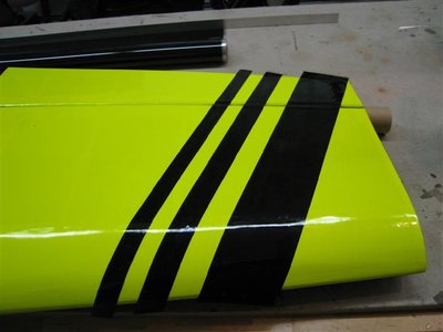

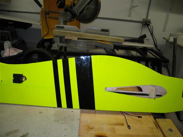

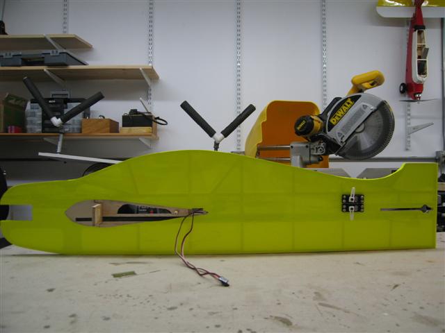

Here is a picture of the servo wires installed in the fuslage
now we start the covering

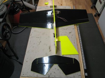

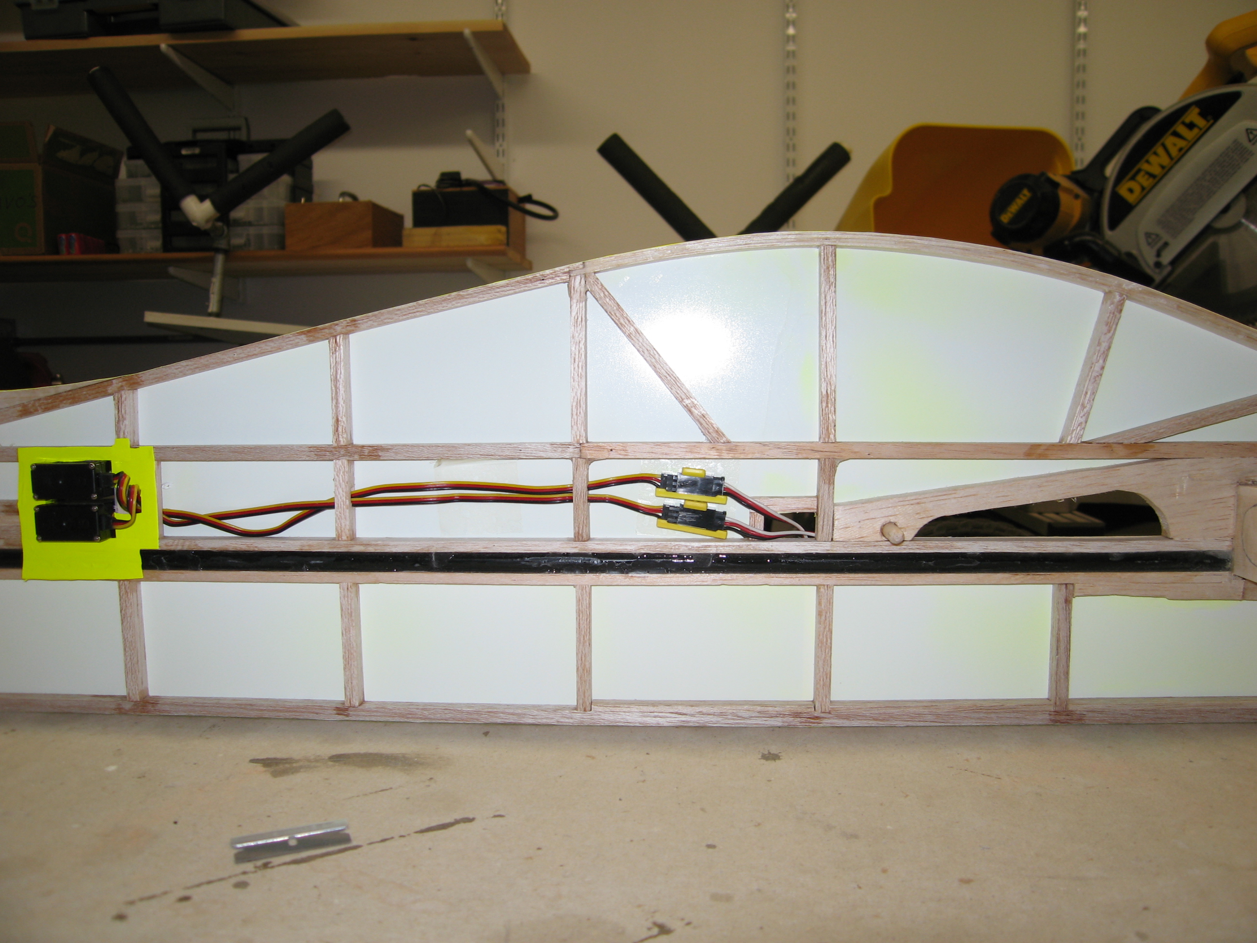

Postby Haggie » Fri Apr 08, 2011 9:38 am
More covering
(Small).JPG[/attachment]

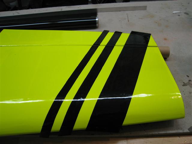

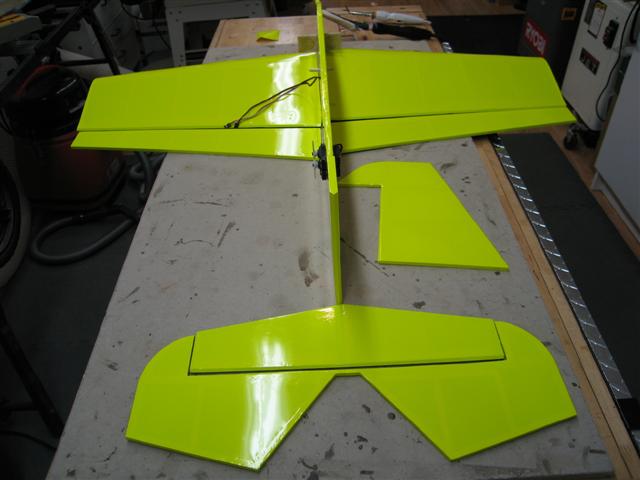

Postby Haggie » Wed Apr 13, 2011 7:25 pm
pictures of detailing
