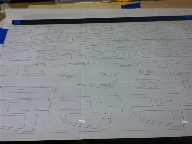

This is the Parts Sheet.

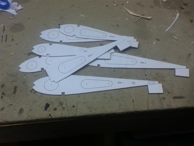

Here are the ribs cut out with the paper still glued on.

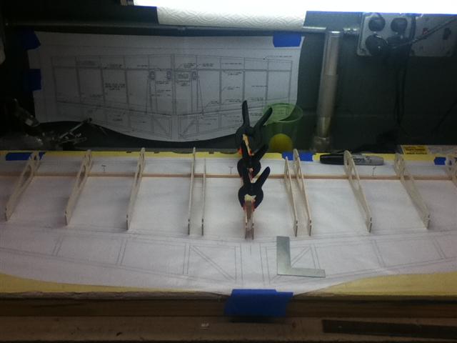

Wings are the best and the Fastest to build. Make sure the ribs are level and you are good to go

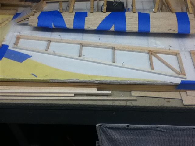

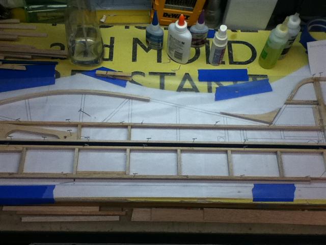

It Took a couple of hours to get the wing done
Almost done

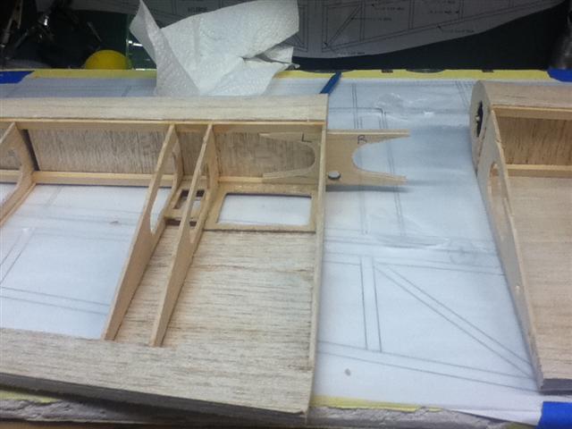

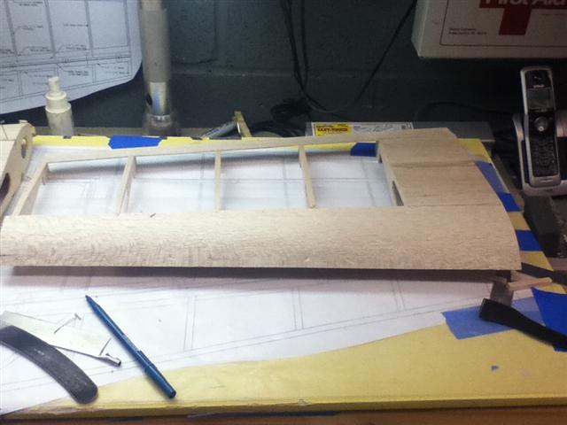

While the wings are drying I started the Ailerons
Ailerons done
Check out the new wing joining system that they came out with. If you look the joiner it is attached to the main spars and has a hole in the middle for the carbon fiber tube. The back of the wing will have anti rotation dowls. You can make the rwing removable but I am not. It's a small profile

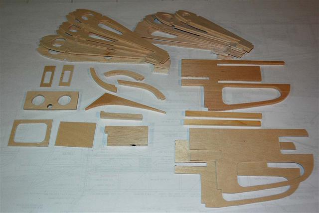

I downloaded the plans. The guy wanted somewhere around $80.00 for the kit.
For $95 dollars I got all the wood and carbon fiber tube to make 2 kits. It just takes some time cutting out the pieces.
These are the pieces that have to be cut. I cant see paying $80 for those few pieces, some sticks and 3 sheets of balsa

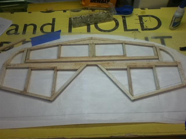

Elevator and stab are done.
Elevator/Stab
