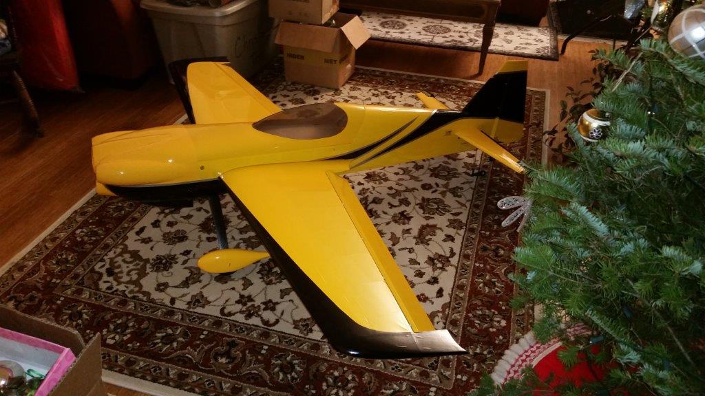

Here are the original pix the day I brought it home:

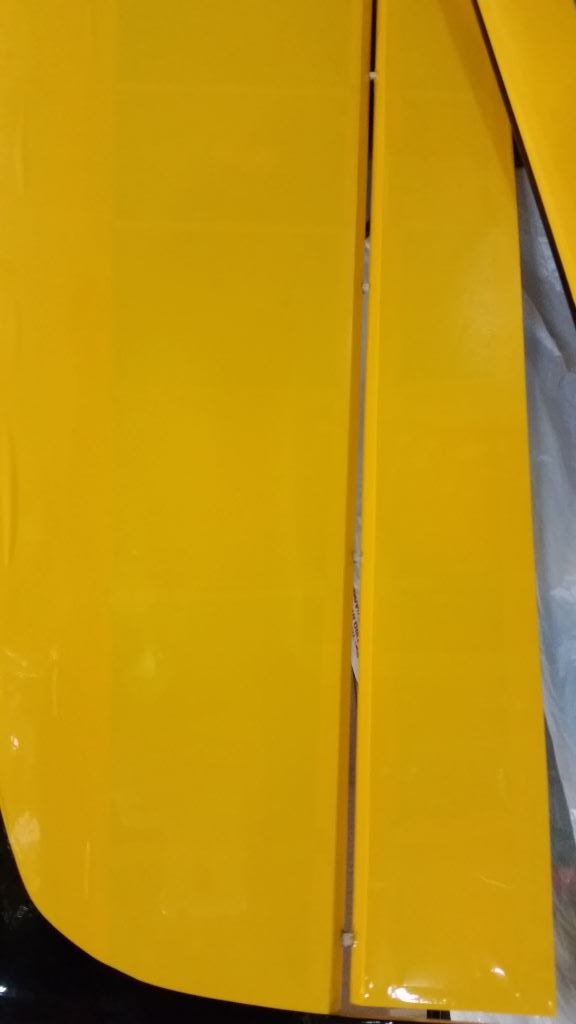

As I stated in my original post, the original owner glued the control surfaces with HUGE GAPS!!
That is the first issue I am addressing.

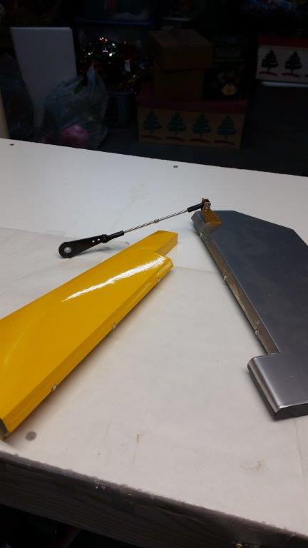

Horizontal Stab & Elevator separated.
Now That's a Hinge Gap!!

Putting considerable time into this plane, not much progress to show for it.
Cutting old hinges, drilling them out & reassembling control surfaces takes time if its to be done right.
Found out that the best way to cut old hinges is with a nice new, sharp #2 Xacto blade in a HD handle.
Steady pressure and a rocking motion cuts cleanly through the hinge.
A dremel with a tiny saw blade or a grinding disc just melts through the hinge, leaving a mess.
Compared to the drill press, the cleanest, most accurate holes i made were by hand.
Started with a tiny bit in a pin vise, & gradually increased size to what was needed.
With the drill press, the bit would flex a little bit & be off center.
Aileron gaps aren't that bad, might leave them.
With tail feathers removed
Rudder back on, taped while epoxy hardens
